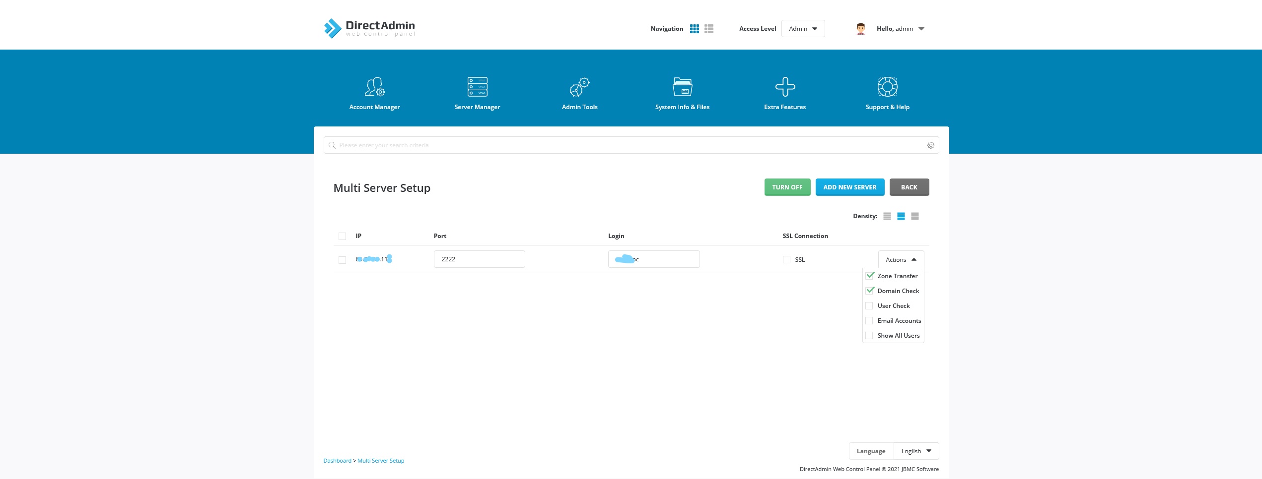

I installed directslave on centos 7. After adding the domain in DA it doesn't export dns zone to server directslave. What could be the reason?
Did you set up zone transfer on main DA server?
I set up a multiserver in DA. Anything else needs to be set?
InkedScreenshot_2021-04-29 162 55 50 60 Multi Server Setup DirectAdmin 1 61 5_LI.jpg
I set up a multiserver in DA. Anything else needs to be set?View attachment 4316
