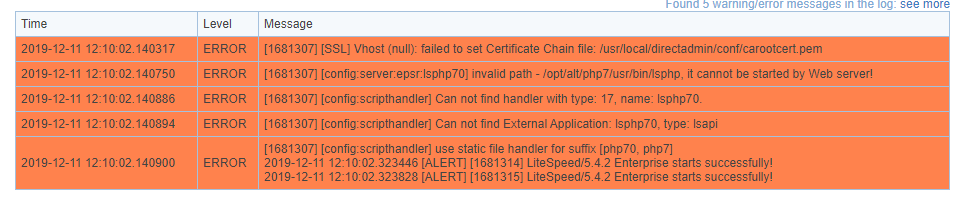

after installing litespeed on a Cloudlinux + DirectAdmin server, it marks the following errors
but the problem does not end there, I have a client who gets a php error
that same client uses an app in node.js, and now it marks an error 403 ... please I need your kind help.

I believe your PHP code requires mysql extension, so you need to switch to PHP 5.x, or upgrade it. The errors in LiteSpeed dashboard are not relative.

I commented that I have tried from php 5.4 to php 7.2 with the cloudlinux selector but I still get the same error, I don't know how to fix it, before installing the litespeed my client worked fine.
CloudLinux selector will work only for users added into CageFS. Do you have CageFS installed on your server? And is the user under question set into CageFS?
Alternatively you might enable:
- mysqli
- mysqlnd (nd_mysql, nd_mysqli, nd_pdo_mysql)
for your user in PHP selector.

I already enabled all the options with the php selector, but still the problem persists, I don't know what to do :(
Could it be that something will go wrong in the compilation?
If the enabled extensions do not solve the issue, the used PHP application might be too old and requires mysql extension, or it needs something else.
I would just go through the code of the PHP application and find out what extensions does it require. If it's not an option for you to debug PHP scripts, then you might need to contact author of the used PHP application and ask them to help.
Meanwhile in order to make sure PHP selector works fine, try and upload/create a simple PHP script into public_html or private_html folder of the site with
