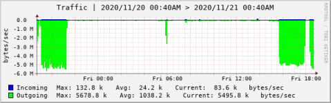

This is my network speed:
From my NETDATA dashboard:
Process is still going but too slow!
