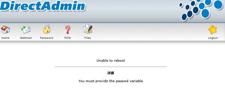

M marua99 New member Joined Feb 9, 2026 Messages 3 Feb 9, 2026 #1 Server Version 1.694 I tried to reboot from the directadmin service monitor, but when I entered the admin password and pressed the reboot button, Unable to reboot You must provide the passwd variable
zEitEr Super Moderator Joined Apr 11, 2005 Messages 16,168 Location www.poralix.com Feb 9, 2026 #2 Hello, Do you use enhanced skin or evolution? May you provide a screenshot with an error?
M marua99 New member Joined Feb 9, 2026 Messages 3 Feb 9, 2026 #3 zEitEr said: Do you use enhanced skin or evolution? May you provide a screenshot with an error? Click to expand... I used enhanced skin. It was able to restart normally until last year, is this due to an update? Attachments DA1.jpg 30.8 KB · Views: 175 Last edited: Feb 9, 2026
zEitEr Super Moderator Joined Apr 11, 2005 Messages 16,168 Location www.poralix.com Feb 9, 2026 #4 I can confirm the bug on my side as well. Only DirectAdmin developers might check and fix it. Evolution skin sends: JSON: {"passwd":"asdasdasd","json":"yes"} Enhanced skin sends: Code: password=asdasdasdn&reboot=Reboot password is sent in different variables to the server by the skins.

romans Super Moderator Joined Feb 4, 2024 Messages 199 Location Ukraine Feb 9, 2026 #7 I have just tested it myself and as I can see: - EVO - can reboot using "admin" password - Enhanced - nether "root" nor "admin" passwords work. So, I will try checking it closer with developers.

romans Super Moderator Joined Feb 4, 2024 Messages 199 Location Ukraine Feb 10, 2026 #9 That issue should be fixed in DA version 1.695. Tomorrow it will be available in ALPHA if anybody wants to test the Server Reboot from Enhanced Skin.
