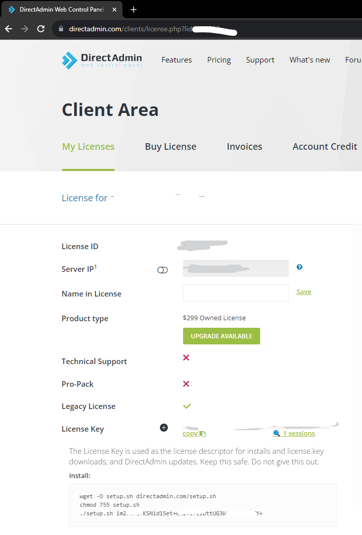

hmm.
i looking this page (directadmin.com client area page)
Which one should I try? Almalinux 8 or 9?

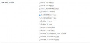

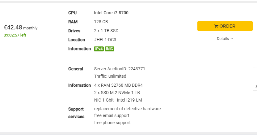

Well, I bought it from auction with a normal Intel 8700 processor. Normally there was no problem. I restarted and it froze. It did not open again. Manual reset didn't work either. Then I reinstalled 10 times :). Each time, after installing directadmin, the server never started again when I tried to restart. I reported a malfunction. They gave me a new server. It didn't get better. I just purchased a new server from an auction. I have now switched to vmware esxi . When I create a virtual server, Centos S8 does not start again after the initial installation screen and the restart command :). I switched to centos S9. Directadmin Beta (with php 7.4 support) and centos s9 work fine. i added example server Screen Shot
