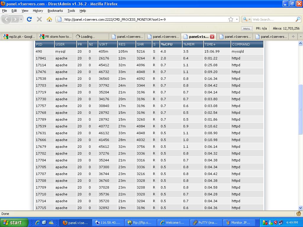

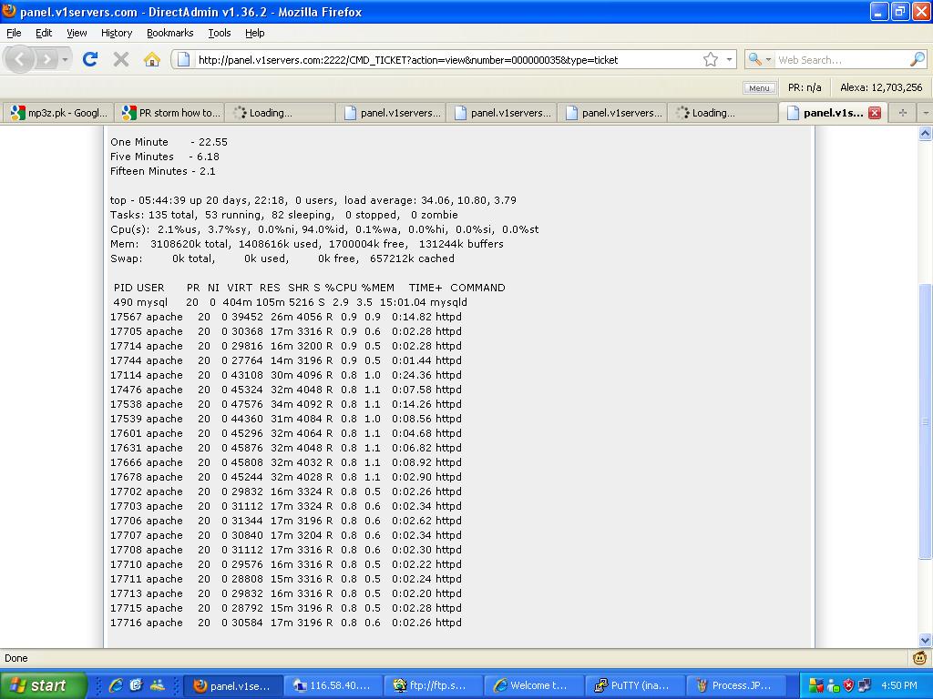

Also previously, after about 1000 attempts to open the Control-Panel I went to options and saw this in Options so I took screenshots ( Attached ) .

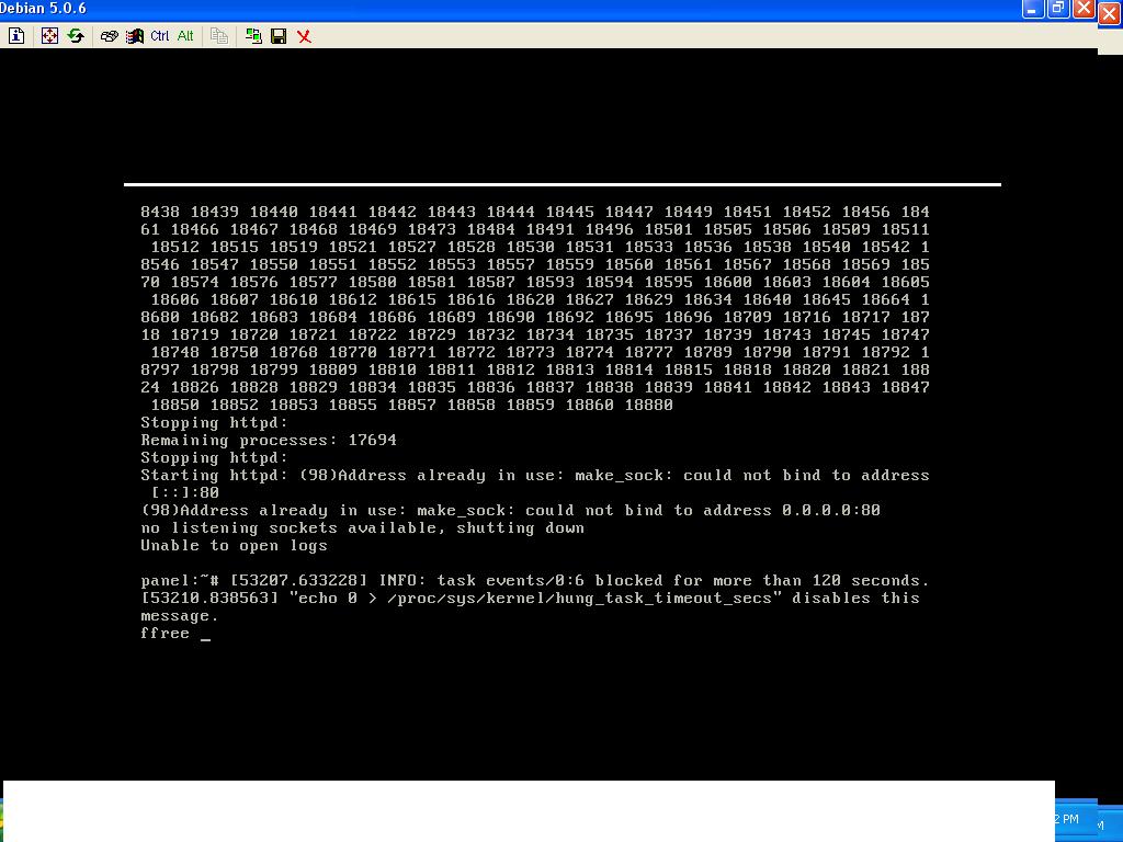

You can see in the screenshots that Apache processes are at Spam. Restarting Apache fixed the issue for me at that time.
But this time, I sent a bit more requests through the Link-Builder software.
So the control-panel didn't work and restart was the only fix.
Please explain how could I fix this .

Users don't use RAM; processes do. you need to determine which of the processes (probably processes started by the user) are using the RAM, and then configure them with limits.

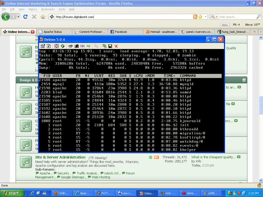

To find out reasons you need gather more information. Top's output is not enough.
Examine apache logs + httpd status. Try to understand what vhost and what scripts make problem. Log mysql slow queries and watch it.

Please Install atop and see interactive output with command:
atop 1
You will able to see, what is going on with your server. Pay attention to red alerts.
I think I got what's happening. I captured the screenshot when it was happening . [ Attached ]
The CPU usage was fluctuating highly from 50-70% .
And apache was being spammed with different process pids.
Each pid using 1-2% of CPU .
Even on stopping it didn't stop perfectly and I had to send about 5 times stop command. Screenshots attached.
And even when I start apache, it starts with about 15 pid files.

The main issue is just Apache process and pids at a lot of spam causing more and more CPU load.
I've just seen RAM/HDD are doing fine. 2GB of RAM is still free.
HDD is functioning all well.
It's just the fluctuating CPU ( caused due to apache ) .
It worked well during the early days but now started to cause problems.
On restarting apache, it starts with 15 pids.
But on system restart, it starts with 1 pid.

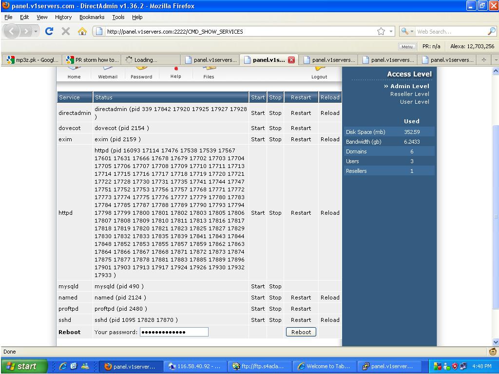

By Process Spam I mean that a lot of those processes start to run by itself and the number keeps increasing with different pids. As you can also see the logs and console scrfeenshot, you can see the system tries to kill them by sending kill signals but they don't stop or quit.
On stopping httpd, it stops all the 50 processes/pids and when started again, it starts with 15 pids. And yes, on restarting system, it starts only with a single pid. I don't know why.
You can kill any process by forcing it to stop:
# kill -9 0000
where 0000 is replaced by the pid.
If the standard kill command doesn't kill them, then there's some reason they've gotten out of control, but...
If stopping httpd stops them, then they don't need the kill -9 command, but then I'd have to ask why apache can't kill them normally. And the answer, frankly, is that I don't know.
Most likely pache restarts with 15 pids because of your settings in your httpd configuration.
Nor do I. You stand a better chance of finding out because you can check your configuration. Note that even if you post your entire configuration here in the forums that doens't mean I can take the time to study it.
