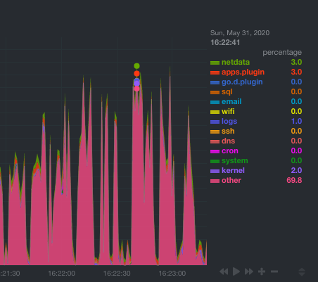

But when I open new NETDATA window over 2222 port with /CMD_NETDATA_SOCK url CPU % was getting higher than ever.
NETDATA CPU was about 2% max. But a new user "NOBODY" on "Users" menu inside NETDATA was consuming more than 40-60% CPU. What?
Before using CUSTOM BUILD (visible on port 19999), total CPU utilization was about 1-3%. After CUSTOM BUILD (NETDATA inside DA over port 2222), Total CPU % was more than 30% due to this "NOBODY" user.

And this is when NETDATA is working inside DA (port 2222):
Some extra images from NETDATA inside DA:

Regarding "top" - your CPU load average is even lower when started in DirectAdmin. You're just showing resource usage of user "nobody", which DirectAdmin runs as :) While netdata runs externally, it runs under netdata user.
Thank you smtalk! :LOL:
Yes, I could see that too. When NETDATA runs internally, then user NOBODY load is about 30.
When NETDATA runs externally, there is no almost no load at all.
Now I will keep NETDATA works externally (port: 19999) so load is not affected, and also due to NETDATA GITHUB ISSUE: https://github.com/netdata/netdata/issues/8531
