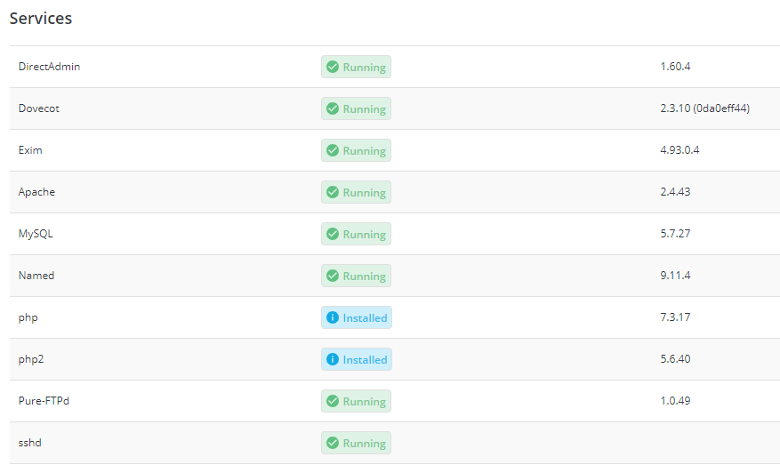

My Directadmin is 1.60.4 everything is well installed
CentOS 7.0 64-Bit
Im switch to php 5.6 on User account after installation prestashop 1.4 with php 5.6 problem CREATE TABLE
everything is updated :(
