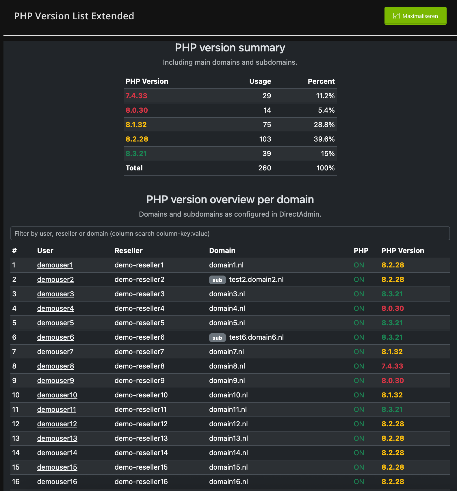

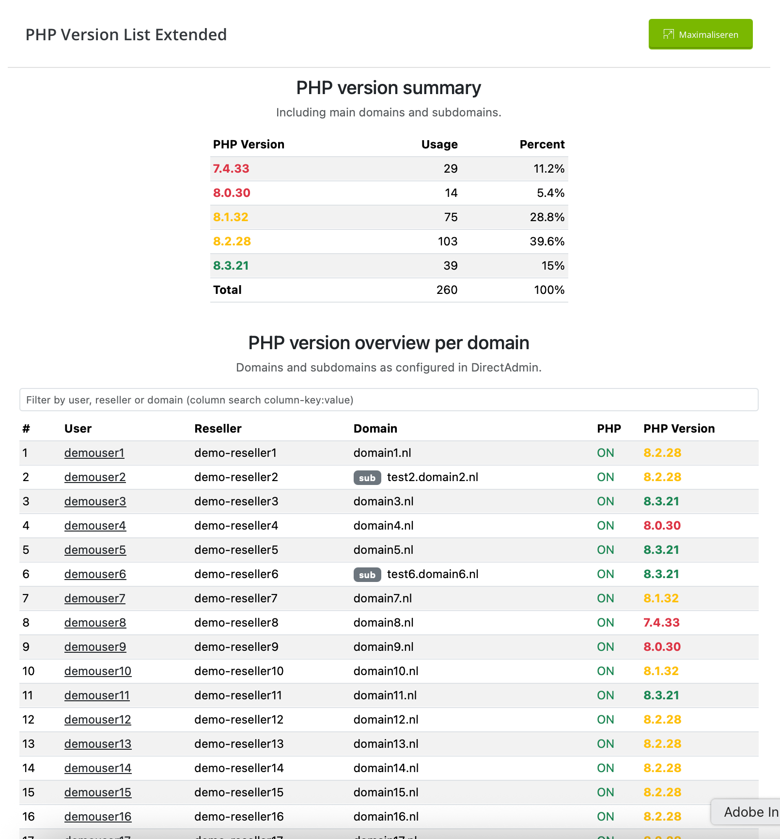

i've just come around to produce some screenshots with demo data. See attached files.
Maybe it's time to open a thread in the 3rd party software about this.
Sweet! Obvs I only spun this up and popped 8.3, 8.4, and 8.5 on it. Looking at the above, I'm liking the colour scheme for older and deprecated versions of PHP. Would be a great feature if you could bulk select the accounts and force them to a newer version of PHP (After notifying customers) but quite promising from a security standpoint. It's good to know what your customers are doing
