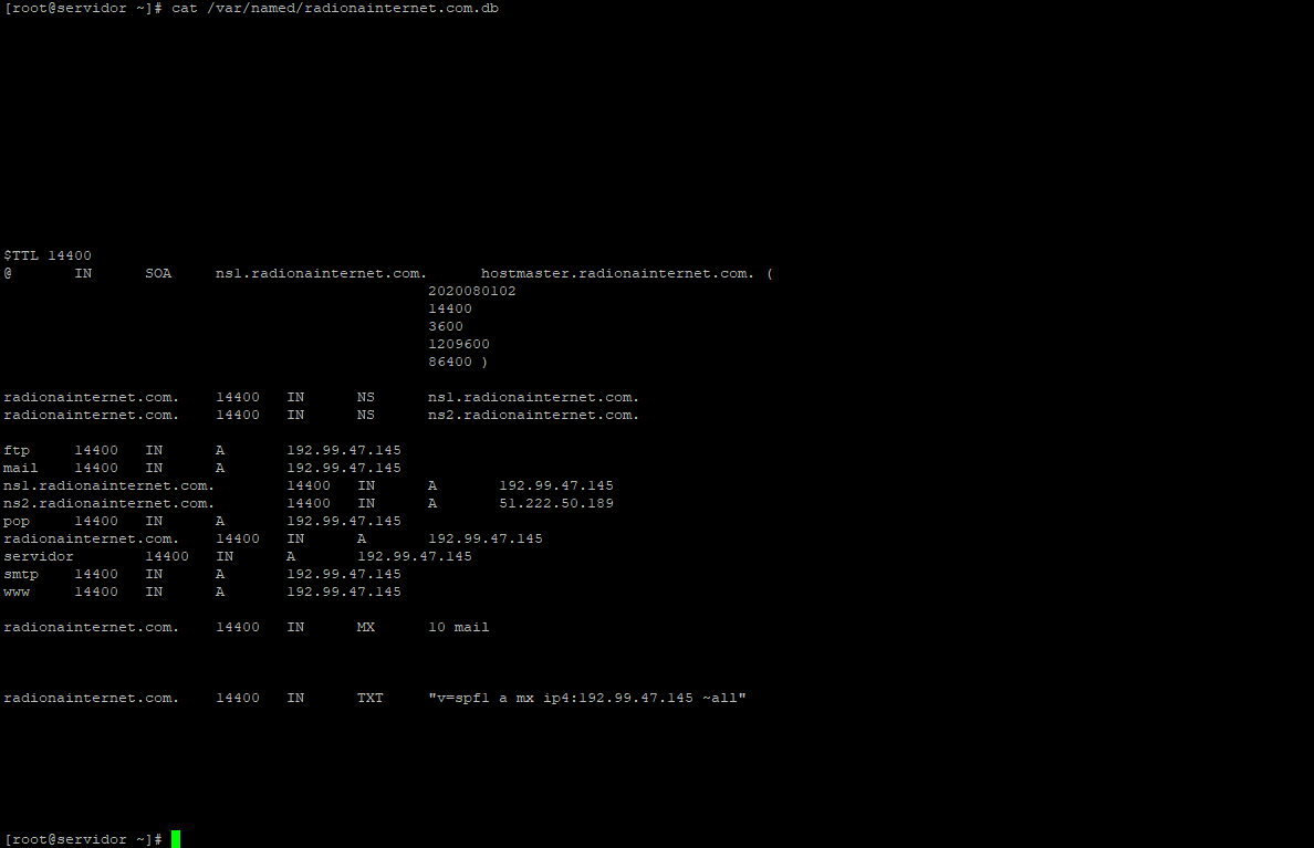

The domain radionainternet.com points to ns1.radionainternet.com and ns2.radionainternet.com Are these registered nameservers?
There are no A records for them.
I queried the nameserver directly and it does answer with an empty result so there is no block. You simply have not added the domain yet.

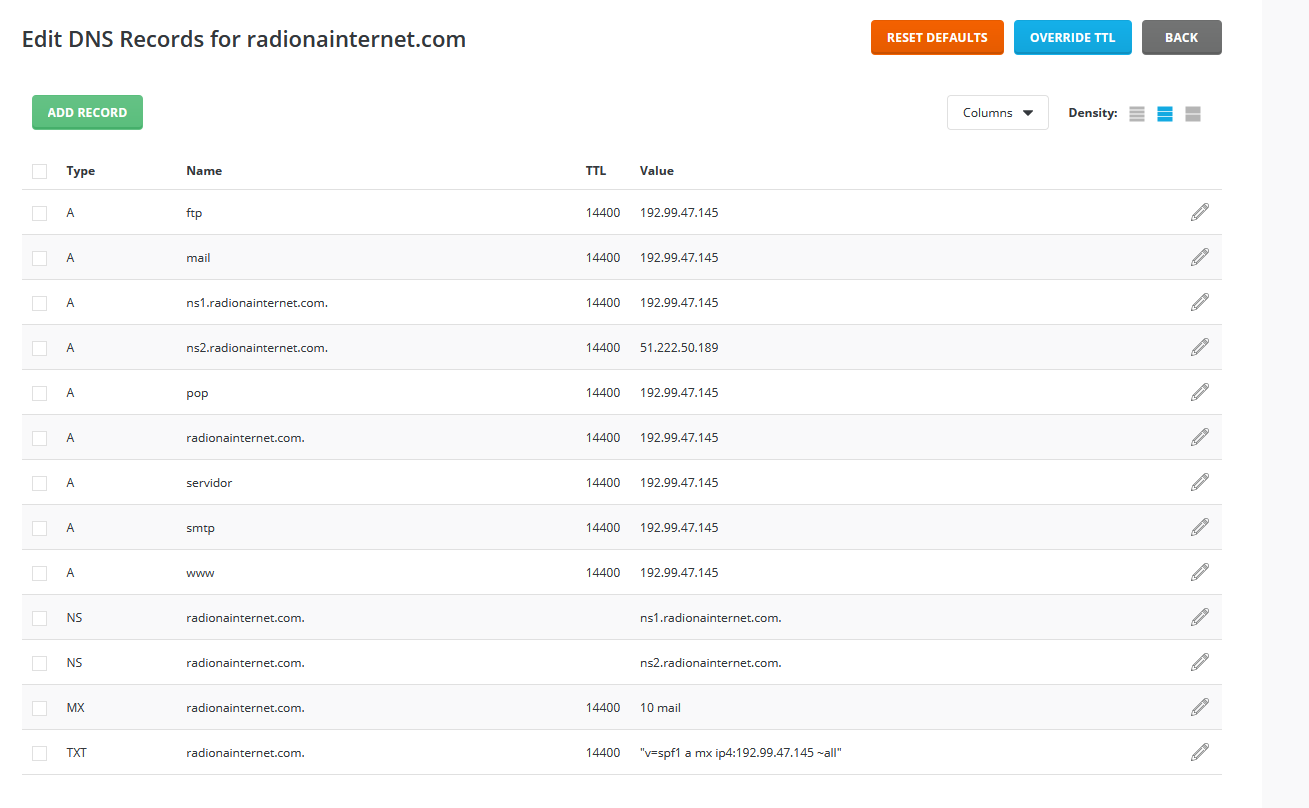

my child name servers seettins in domain.
domain radionainternet.com created
dns settings in domain dns zone
DNS records seeting in hostiname zone
bind open
I believe that I don't need to do anything besides these right settings?
Is there anything else missing? I already looked at the settings via ssh and they are also correct.

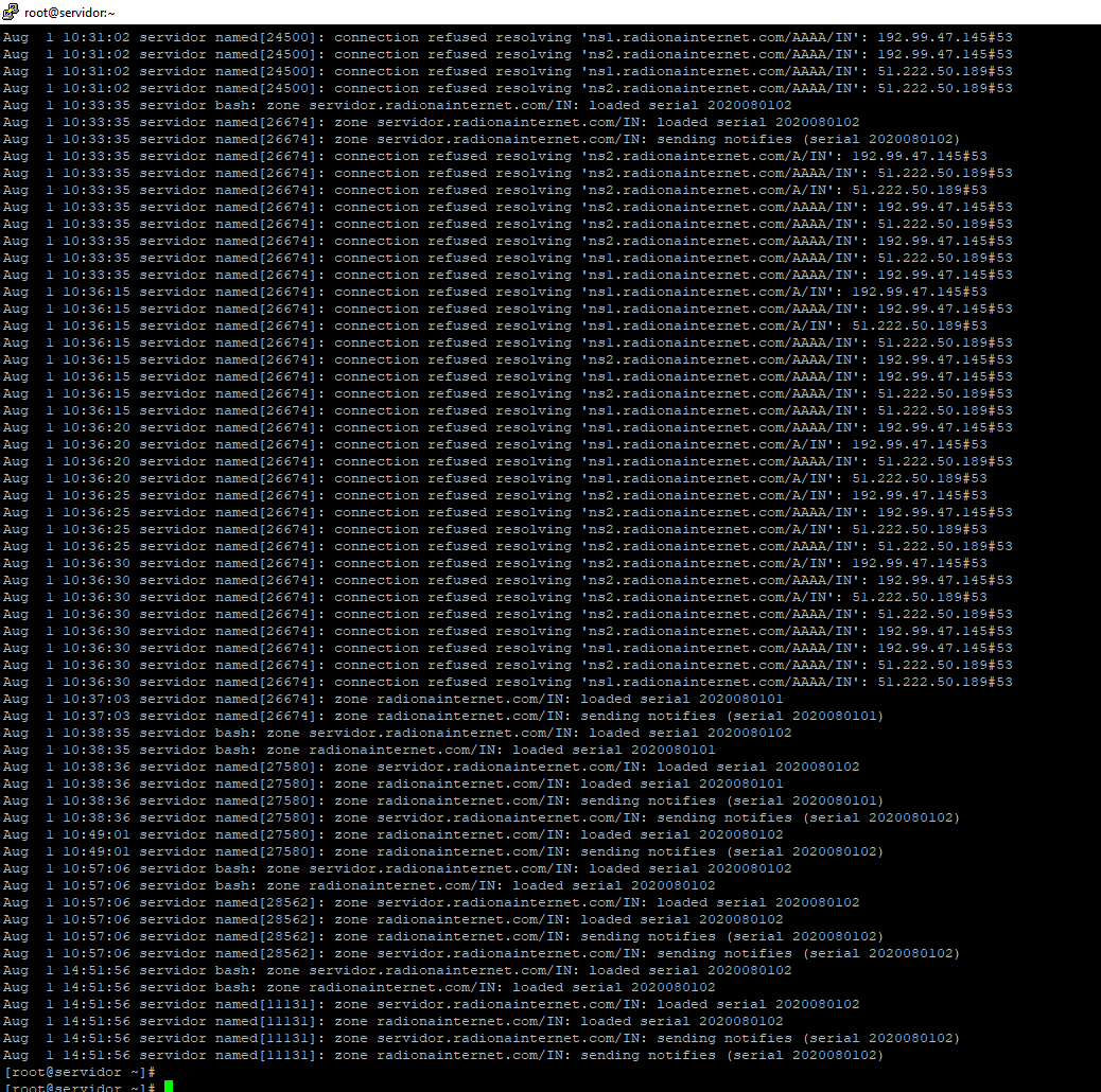

I am not sure why you keep doing nmap. You want
netstat -npa | grep named
Also
grep radionainternet.com /var/log/messages
grep radionainternet.com /etc/named.conf
cat /var/named/radionainternet.com.db

Let's narrow down the messages a little:
grep radionainternet.com /var/log/messages | grep -v query

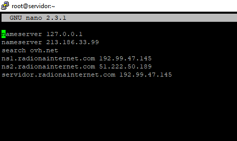

resolv.conf doesn't really have anything to do with this. But mine is simply:
nameserver 8.8.8.8
nameserver 8.8.4.4
