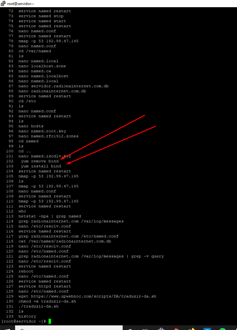

before asking for help here on the forum I had removed BIND and installed it again, but it didn't work, it seems that on my server whenever I remove and install it again it will come with the wrong configuration ..

I removed the bind, installed it again, see the configuration.
As I told YOU I get this also when reinstalling bind. There is no way its related to the data center.

Ok its been confirmed that the installation of DirectAdmin does in fact modify the named.conf and comment out the allow-query line. So the allow-query problem was caused when you reinstalled bind.
If you had a problem before that then it was something else and its no way to know what it was now.
