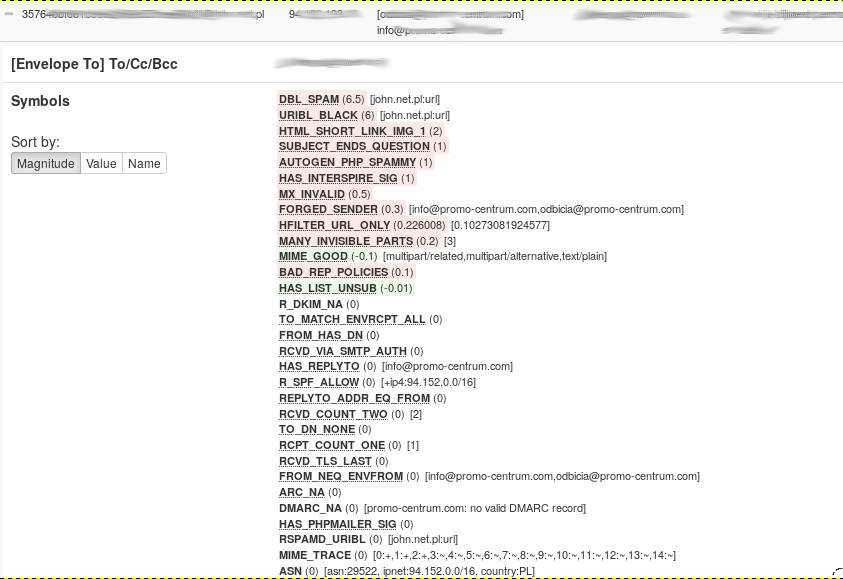

Also, when i expand a message i do not see all details:
While on another instance (not DA):
Any tips on how to adjust this?
