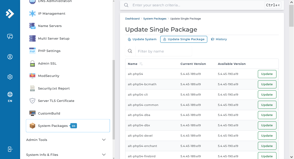

I already have all of the old versions of PHP set to no in the admin section.
When I run the command in SSH
da build set php2_release no
it says
php2_release is already set to no
I know there arestill lots of old php scripts because the DirectAdmin section wants me to update the old php scripts on a regular basis
Attached is a screenshot of DirectAdmin wanting me to update these packages.
This screenshot if from hours after this was posted
You are using CloudLinux OS and have installed PHP that comes from CloudLinux too. In that case please reach CloudLinux support to get more details how to correctly deal with those packages.

You might try and run (then command will first list packages w/out actual removing them):
yum remove alt-php*
DO NOT hit 'y' when asked.
You might first review the list of dependent packages and unused dependencies, which are offered for a removal.
Bash:
Is this ok [y/N]: n
Operation aborted.
If you are 100% sure you don't break the things, hit 'y' to proceed with a removal.
p.s. You might post an output of the command here (without proceeding to a removal), if you are hesitating...
Thanks for your help.
I ran yum remove alt-php* about a week ago and , so far, I have not received any more update old php scripts since then - hooray.
