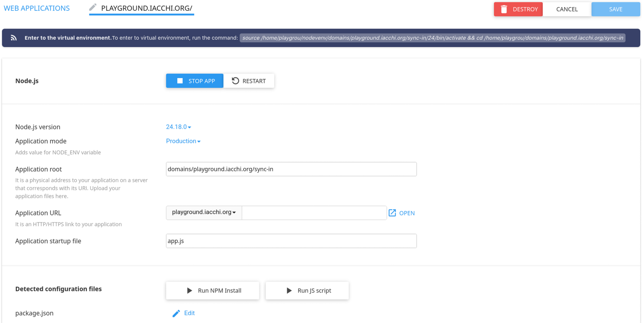

In the Extra features section of DA I clicked on Setup Node.js App, then on Create application. This is how the application configuration looks like:
