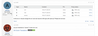

Hi everyone
I need to understand
I found this https://forum.directadmin.com/threads/directadmin-server-hostname-nameserver-question.61431/
and I added those 3 records as you see, to my surprise no "server.mydomain.com is the hostname and name server.
I thought that shouldn't work.
here is the steps that I did
1- change the host name to server.mydomain.com and NS1 and NS2 update for the new domain
2- updated the DNS record on Direct admin and added to NS1.my domain.com. and NS1.my domain.com. (included the trail dot at the end)
3- checked the directadmin.conf and server.mydomain.com is there the record of NS1 and NS2 are there.
4- made sure that my doamin on cloudlflare record has
Search
Add record
Your search yielded 3 results
Type​
Name​
Content​
Proxy status​
TTL​
Actions​
A
ns1
1.23.45.67
ProxiedAuto
EditWhen toggled open, an additional table row will be added below this row to enable editing DNS records.
A
ns21.23.45.67ProxiedAuto
A
server
1.23.45.67
ProxiedAuto
to be clear
1- server.mydomain.com:222 is working to access DA
2- but not working with mydomain.com:222
my question:
what issue with using Cloudflare domain registration this way?
otherwise, I need to move the domain to another registrar.
any used this methods
Thank you All

Please check list Port supported here.
As you know,
nameserver ( ns{X} ) use port 53
you must grey cloud, if application don't have the ports list that support on cloudflare site.
As you know,
yes agree it works only with the grey cloud. once I turn the proxy doesn't work
