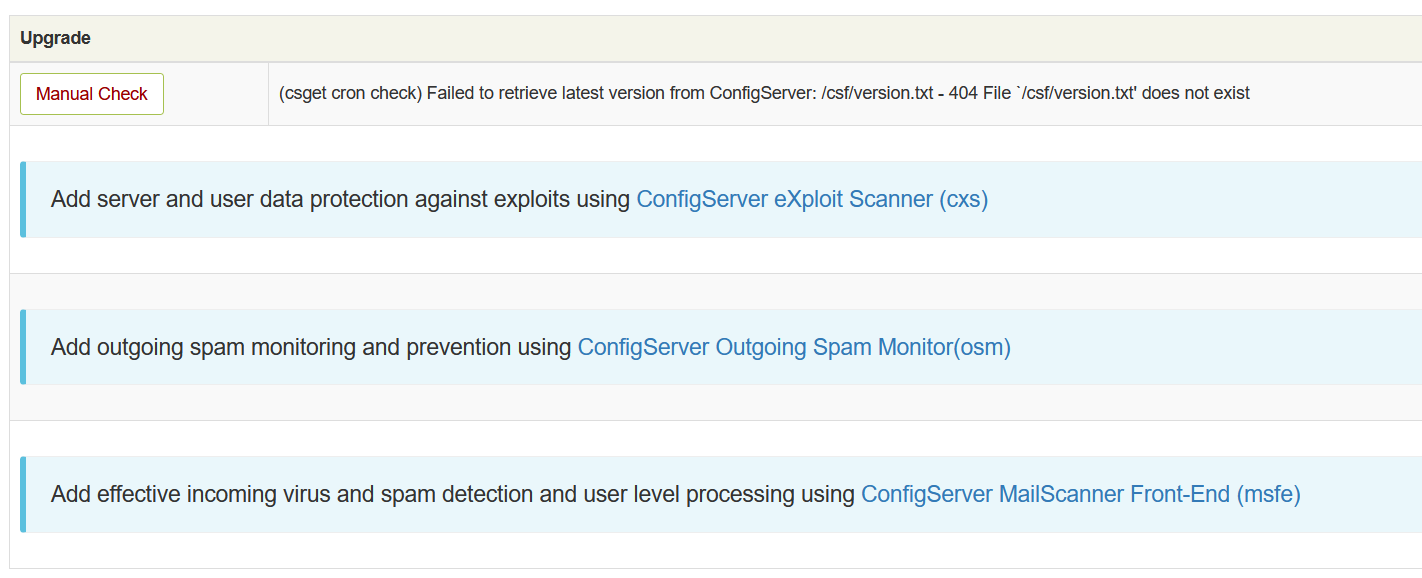

But I think the attached stuffs should get removed. Taking unnecessary space.
