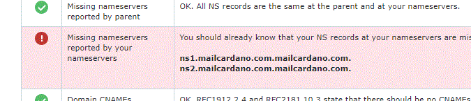

intodns reports:
Missing nameservers reported by your nameservers
You should already know that your NS records at your nameservers are missing, so here it is again:

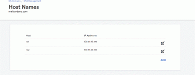

thank you for your reply, but i am not sure if I understand what you mean
at the registar it looks like the attach pictures, can you help me understand better your comment please?

yes they add the rest od the domain automatically, see this pic that shows that

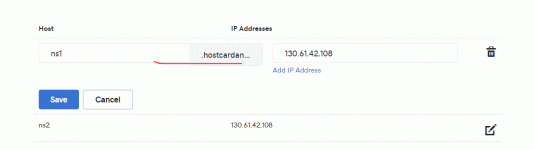

anyway, I try to update and look what happen

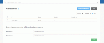

and this is how it looks the "nameservers" you mention

Oke so if they automatically put the rest of the domain name behind it at the registrar, just put it back as it was before. Like you showed me in the screenshot of post #5.
Be aware of the fact that it can take up to several hours before nameservers are synced.

I see in DNS on Directadmin, you are wrong in A record, you must point ns1 and ns2 same as pop / smtp (not ns1.mailcardani.com and ns2.mailcardani.com)
No that is not wrong as long als the full name is followed by a trailing dot like was done here.
So you can either use
ns1 ns2
or
ns1.mailcardani.com. ns2.mailcardani.com.
that is both correct.
