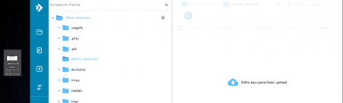

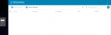

In addition to the problem with the Backup restore, I also noticed that the File Manager has stopped following the theme color of Evolution. That is, if Evolution is red, the File Manager follows the default blue color.
Another problem is also with the upload of files to the File Manager (drag and drop). Depending on the screen resolution, when dragging the file to the directory, nothing happens (and if we drop the file, an upload appears, but it does not stay in the directory). We need to right-click and go directly to the "Uploads Files" option.
However, if we increase the screen size a bit and the File Manager layout changes, when we drag the file the upload box is displayed normally.
