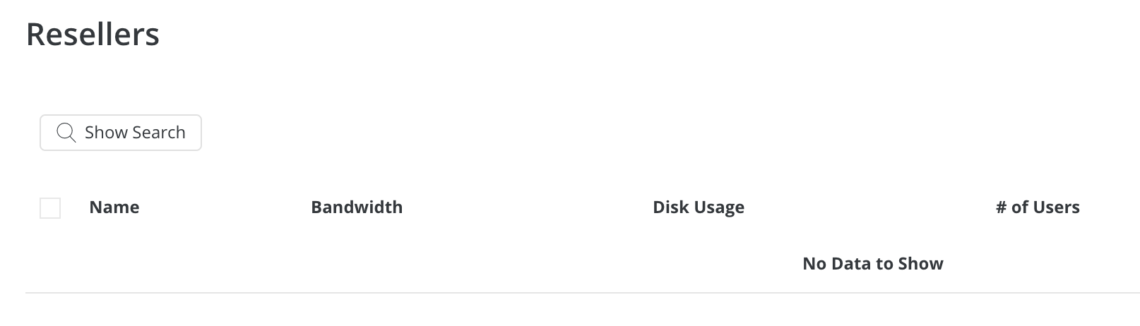

Hi everyone,
I'm facing a weird issue with my da license. I have the da personal license. I was using trial purchasing the license. I converted one reseller account that I migrated from cPanel using a directadmin guide.
However, now DA says that I've exceeded Reseller limit and some features such as MySQL administration wouldn't work. Please see the screenshots below.
Any help will be greatly appreciated.
Regards!

Hi bdacus01, but I have "zero" resellers accounts from the screenshot above. "admin" account might be one by default, but I have no clue what the 2nd reseller is.

I only have one user & one reseller - that is admin. Under admin I have 4 domains (limit is 10 here.) So I'm well within limits. But I still am getting the "Limit Exceeded" error.
