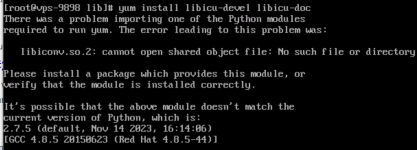

Sorry, but I need some advice/help here. None of the 4 php-compilations are running anymore.
When trying to rebuil/install I get: libiconv.so.2: cannot open shared object file: no such file or directory.
Any command I run keeps giving me the same error so far.
My goal is get php back up and also my phpmyadmin (I cannot logon to my databases anymore, since my core/php_1 is also no compiling (however so far directAdmin is still running.

Have you seen and tried this post (click) to restore old libiconv for the time being?
He Richard,
Thank you for your reply. With that post I got libiconv back installed and now my php is back up and running (until 7.3).

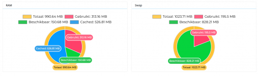

I'm running CentOS linxux 7. Have +/- 1000MB RAM and running also SWAP.
My named-service is not yet back up; not sure if it is was caused by the same issue. I will ping more info on that tomorrow.
1000MB RAM
In total? So that is 1 GB RAM??? That is very little. It's the bare minimum. Would be better to have at least 2 GB.
I hope your swapfile is at least 4 GB too.

His swap is also 1gb
So would recommend to run max 1php version.
But way way way better would be to upgrade your system
That is too low. Minimal requirement to run DA is 2 GB swap space at least.
Indeed better upgrade.
