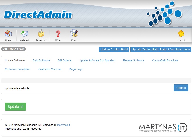

If I change a versionnumber with the plugin, like changing PHP from 5.6 in 7.1. Whatelse should I do to effectuate this update?
I can do it on the server with the scripts, but I'm wondering if (and how) it can be done with the plugin.
On the first update tab, i see only the php1-release with my installed PHP 7.0.
How can i update the version of php2-release (5.6) to the last version in the branch?
Or is this just only showed when there is a new version-update in the branch?
That's because there is no update for the other release, on the update tab you should see just the applications that have an update available.
