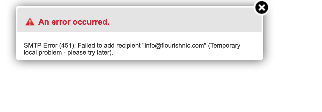

We are unable to send email via round cube.
"An error occurred.Close
SMTP Error (451): Failed to add recipient "[email protected]" (Temporary local problem - please try later)."
Please check the attached file.
Any advise please?

Login via SSH to your server.
cd to /var/log/exim
use either nano or vi (vim) to open mainlog and see if you can find references to this error.
If you're not an admin (so not a DA customer) you're at the wrong place, in that case you have to contact your host.
