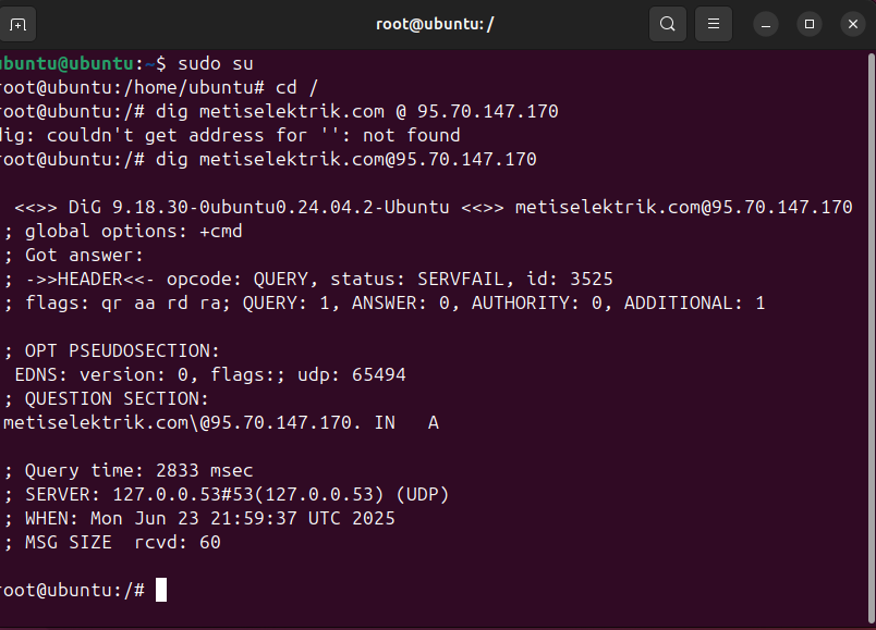

Also looking at 3rd image and looking on https://dnschecker.org/ your server is not reachable, it cannot see any A record, MX or even NS records for elektrikakademi.com. Looking more and more like a DNS issue here, along with a potential firewall issue as I can see port 22 open from the internet, but important ports like 53, essential for DNS is closed and 80 essential for http. Check your firewall first and then when your ports are open, cheack all your server DNS settings. Hope that's a little help, giving you somewhere to start
My ports are open and no firewall other than csf is running. This DNS problem does not exist 2 weeks ago. I changed nothing but this problem occured:(

just test it by use this command from outside your datacenter .
dig your.domain.here @{Server_IP}
while trying to fixed the connection problem.
p.s. relate to "/etc/resolve.conf", don't use "127.0.0.1" (local resolve), it's gonna create some weird problem.

When I use dig from outside network, i got this

Just to be sure. Did you register your nameservers at your domain registrar?
Because I can't find them with a dig command, so it looks like it's only spread because it's present in DA, but you have to also set them at your registrar. Did you do that?

I reinstalled server and directadmin. For now, only port 53 can not be reached outside the server network. All other ports are working. I dont understand why directadmin does not work directly after a fresh install
Yes I registered at my domain registrar.
Well that is very odd. Because then with a dig -t NS on your domainname, then I should always get the NS records, even if your nameservers are not working or are offline.
And this is not the case at the moment.
I would suggest to contact your domain name registrar and have them kick the nameservers again.
