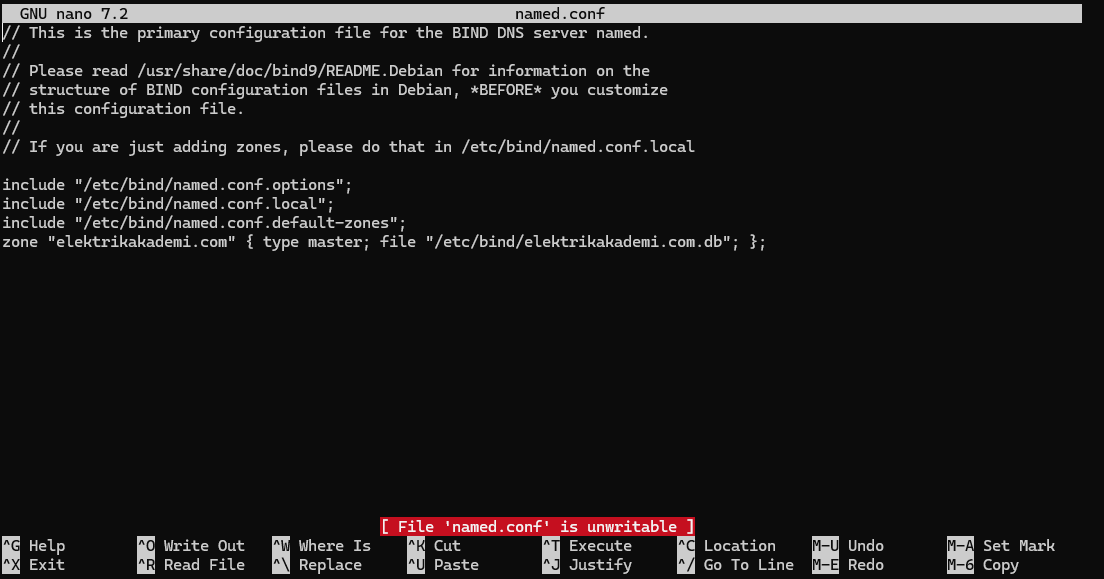

Thanks for your response. Port 25 is something strange but it is solved after adding 25 to udp ports of csf. Anyway I waited till end of da build all procedure. I am using Ubuntu 24.04 running on a raspberry. Should I use different linux distro? I am attaching my named.conf file.
Your named.conf file is unwritable there. Could be 2 reasons, 1 is you're not running nano as root, and 2 you may not have correct permissions set on file.

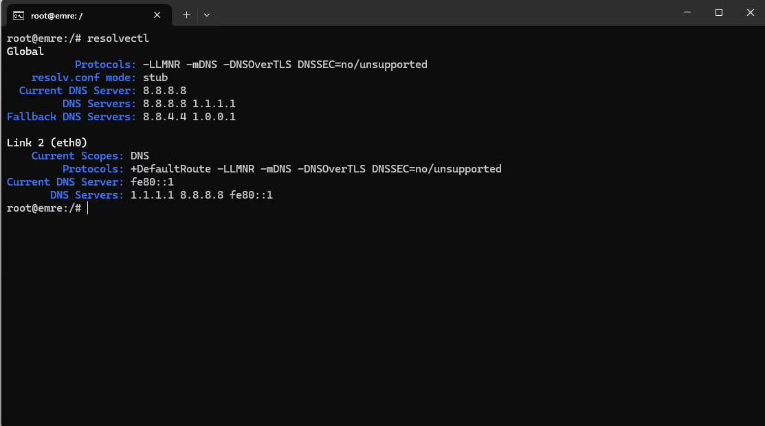

If you're running ubuntu 24.04, have you checked your DNS setup? To do this, type in 'resolvectl' at the root prompt and it will give you details of the nameservers your server is using to get it's info from. It may return something like:

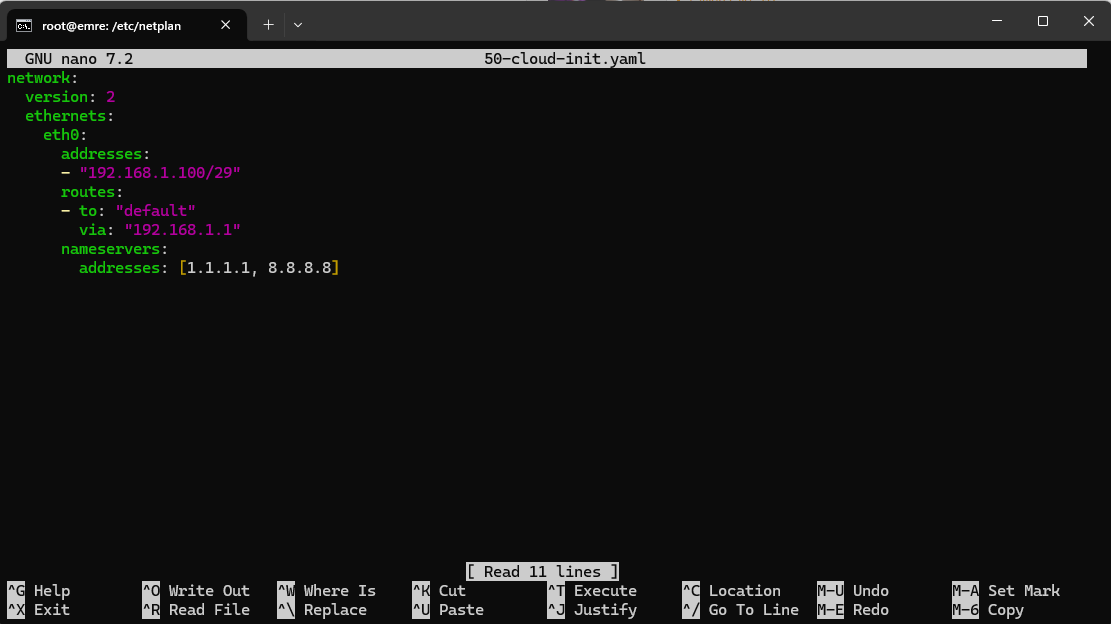

in the /etc/netplan folder look for a file like 50-cloud-init.yaml (Should look something like this):
network:
  version: 2
  ethernets:
    ens18:
      addresses:
      - "10.0.29.2/29"
      routes:
      - to: "default"
        via: "10.0.29.1"
      nameservers:
        addresses: [1.1.1.1, 8.8.8.8]
Make sure nameservers are there as they will help.
Any changes to this file, save, then run:
#netplan try
#netplan apply
network:
  version: 2
  ethernets:
    ens18:
      addresses:
      - "10.0.29.2/29"
      routes:
      - to: "default"
        via: "10.0.29.1"
      nameservers:
#netplan try
#netplan apply

DirectAdmin would have failed to add the zone into the file, if it was the case.
I did not login as root while I was taking ss. Therefore it says "unwritable". Is there any configuration for directadmin to login as root while da build all. I thought it aotumatically login as root and make config

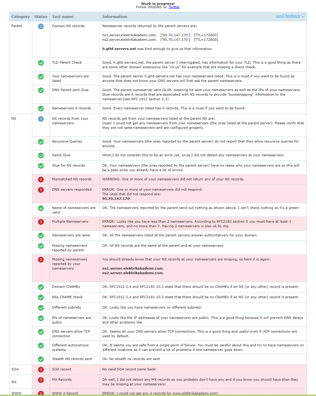

I have done some stuff but nothing changed. Still getting DNS error on intoDNS. I am attaching images for my situation
Also looking at 3rd image and looking on https://dnschecker.org/ your server is not reachable, it cannot see any A record, MX or even NS records for elektrikakademi.com. Looking more and more like a DNS issue here, along with a potential firewall issue as I can see port 22 open from the internet, but important ports like 53, essential for DNS is closed and 80 essential for http. Check your firewall first and then when your ports are open, cheack all your server DNS settings. Hope that's a little help, giving you somewhere to start
And I have new problems. After these changes, my server cant connect to internet and after I added dhcp4: no dhcp6:: no accept-ra: no I couldnt connect my server locally:D
