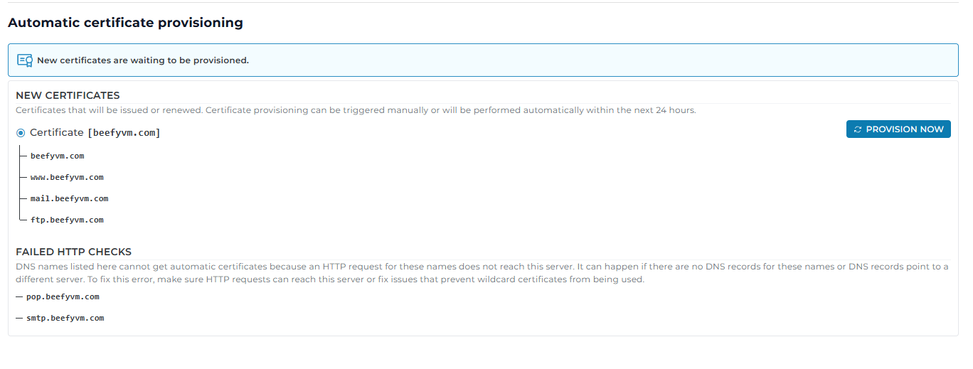

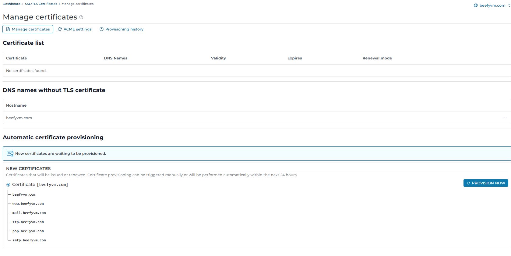

However: if my nameservers were used and someone removed the 'pop/smtp' DNS entry. With "preferer wildcard" turned off. What would happen then? I tried doing this with a test domain, and this is what I see after removing the DNS entries and removing the existing certificate:
And when clicking "provision now" I indeed see that is it trying "pop/smtp". But (as expected) that fails.
2026-09-17T11:44:13.562399396+02:00 ERROR Error error="renew certificate: could not obtain the certificate for \"beefyvm.com\": resolver: one or more domains had a problem: [pop.beefyvm.com: invalid authorization: acme: error: 400 :: urn:ietf:params:acme:error:dns :: DNS problem: NXDOMAIN looking up A for pop.beefyvm.com - check that a DNS record exists for this domain; DNS problem: NXDOMAIN looking up AAAA for pop.beefyvm.com - check that a DNS record exists for this domain] [smtp.beefyvm.com: invalid authorization: acme: error: 400 :: urn:ietf:params:acme:error:dns :: DNS problem: NXDOMAIN looking up A for smtp.beefyvm.com - check that a DNS record exists for this domain; DNS problem: NXDOMAIN looking up AAAA for smtp.beefyvm.com - check that a DNS record exists for this domain]"

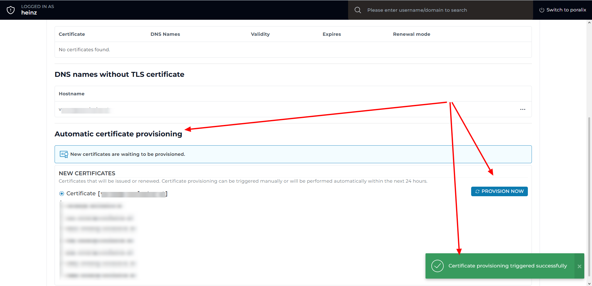

@fln DA fails to create/install a certificate for a domain, though it says a certificate created fine.
How to debug and investigate the issue?
