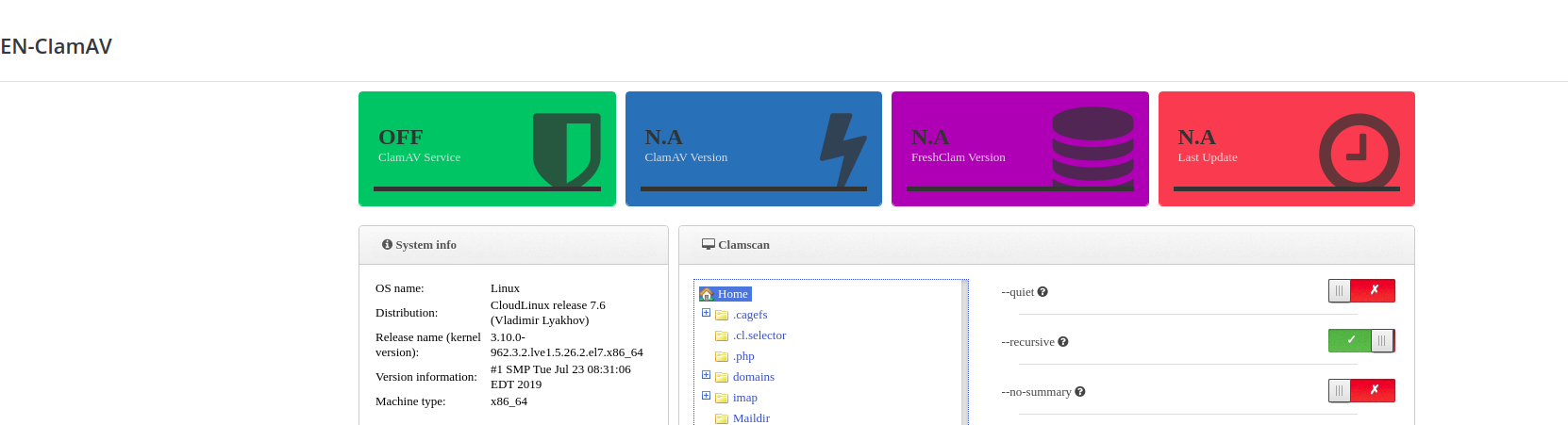

Hi Active8,
Please ssh to your server and post the output of:
Code:# service clamd statusCode:# clamscan --version
Also, please try to remove(DELETE) the plugin and reinstall the last update = https://www.directadmin.ereznet.co.il/en-clamav/en-clamav.tar.gz

[root@ssdda ~]# clamscan --version
ClamAV 0.101.2
Using Cloudlinux 7 and imunifyAv is enable already
