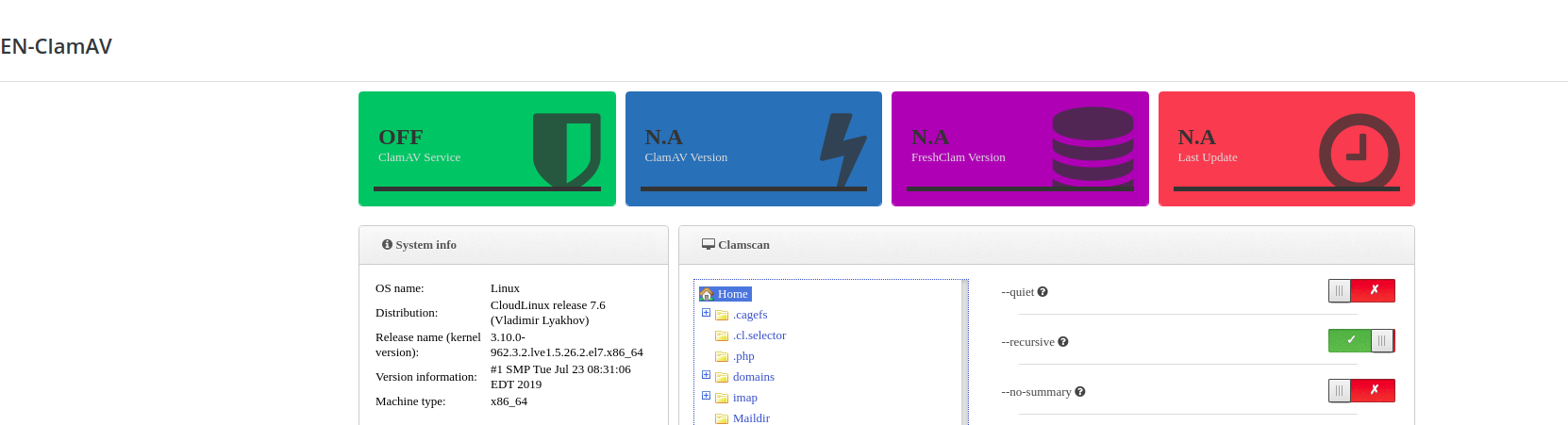

En-ClamAV coming up in the menu. But nothing displaying there. anybody can help me?
I added zend extension at the bottom of /usr/local/directadmin/plugins/en-clamav/php.ini
and keep the file in folder.
Thanks in advance.

idatahost
Feb 16, 2020
17
problem solved. and followed this step:
* delete the plugin from Plugin manager
* Added plugins_allowed_run_as=1 this line in /usr/local/directadmin/conf/directadmin.conf
* From plugin manager again install using this link: https://www.directadmin.ereznet.co.il/en-clamav/en-clamav.tar.gz
* download the ioncube loader and keep both of following files:
ioncube_loader_lin_7.4.so
ioncube_loader_lin_7.4_ts.so
in this location /usr/local/directadmin/plugins/en-clamav/
* edit php.ini file which is located here /usr/local/directadmin/plugins/en-clamav/
and added this line
zend_extension = "/usr/local/directadmin/plugins/en-clamav/ioncube_loader_lin_7.4.so"
mission successful :)
Thank you for this plugin <3
