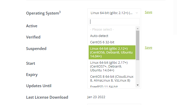

I was able to run CentOS 6 with PHP 5.2.17 and MySQL 5.1
Compiled onLinux 64-bit
Compile DateDec 31 2021, 11:58:02
Server Version1.63.4
Current Available Version1.63.4
I know its not an ideal OS to continue to run on, but at least its giving my customers a little more time to prepare for the migration.
Like this,. I'm sure it can be done with later PHP versions.
Were you able to update DA on CentOS 6 by changing the licence from CentOS 6 to Linux 64-bit? Could this not have unforseen consequences as recent versions of DA don't support CentOS 6 anymore?
I hope this is still supported for more time.
It says CentOS6.
I don't need to update the DA itself,. just keep it active as it is will be fine until we retire these servers.

Seems like you are right, I was able to update a Debian 8 server to the latest DA version by changing the license from Debian 8 to this one.

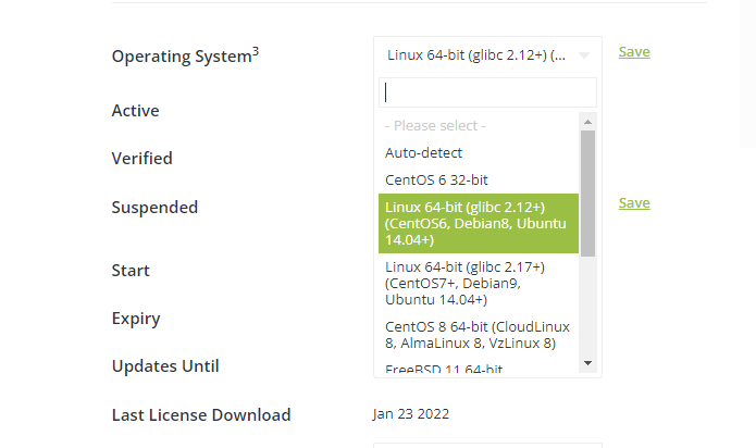

I got this to work on one server (change license from Debian 8 to Linux 64-bit glibc 2.12+, manually update DA, run updateLicense.sh script) where the 'compiled on' license now says 'Linux 64-bit' and everything works fine.
On another Debian 8 server I tried this on the 'compiled on' license keeps saying 'CentOS 6' and I'm unable to start Directadmin due to a license error. Overriding my OS to Debian 8 and updating reverts Directadmin back to version 1.62 which is too old for the new licensing system. Is there any way to force the 'compiled on' license to 'Linux 64-bit'?
I also have some old Debian 8 servers with DA which are actually just online still while some clients sort out their last migrations. I would hate to be forced to dist-upgrade these, or hack around like discussed above to get a newer version than 1.62.x. Yet I am forced to do something as they won't be able to complete the last migrations without control panel.
Out of the box suggestion: why not allow us to consciously switch to an unportioned licenses for EOL operating systems? It would solve everyone's problem, and if the server is dist-upgraded after all it would automatically revert to portioned licenses anyway.
update: it was actually trivial to update all to 1.63.5 using the Linux 64-bit version so my problem is solved. Still think the above is a good idea :)
